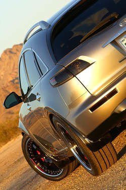

heres another, 1/2 coil front & rear upper spring spacer cut... don't look quite as low as rookies though... maybe the different offsets affects the appearance too a bit...
ride is really not much worse than stock H&R's, maybe slightly stiffer in the front, but not bad at all... with the H&R's I think each half coil equals aprox 1/2" drop... don't think it would be a good idea to go more than 1 full coil anyway, spring'll start to be loose in it's pocket & want to pop out at full extension... also, seen some claim to have cut the rears too but both ends are formed ends so might not be the best idea to cut the rears really...

yeah, now that you mention it, that is part of the difference too I guess, mine are a little shorter, 315/30-22 & 265/35-22. looking at your pictures again I see the difference in tire height...
