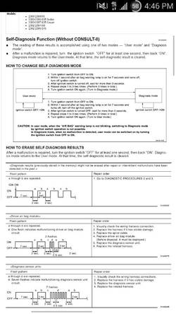

Hey guys, my airbag light came on. The diagnosis from Infiniti was to expensive to try, so I thought I should get a code reader. Apparently, the OBD2 or OBD1/2 & ABS readers don't read SRS.. And even the SRS readers are expensive lol, so I stumbled upon a diagnosis for us without the Consukt-II or equivalent readers.
There are more options on the bottom, but my flash pattern was the second one 'driver air bag module' I even recorded the sequence.
Question is where would the wiring harness connection be located??
I think the spiral cable is located within the steering wheel as I've been browsing the 'paddle shift' DIY installation for years lol
