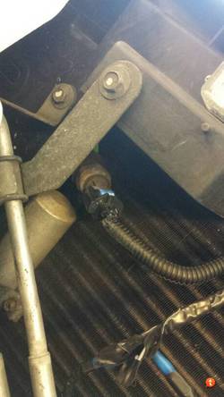

Got the a\c recharged and checked everything. Still not working. Then checked the ac pressure switch. If i push the plug up boom the the a/c works. If i push the plug down it shuts off. In the end now i need a a/c pressure plug like this pic. Anyone have an i idea where to get just the plug?
