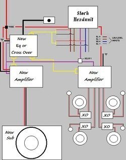

Best way and what I would do is:
New component speakers in doors
New speaks in rear doors.
New 4 channel amp powering them.
DO NOT use dash speakers or rear pillar.
From my BOSE WIRING GUIDE: https://www.infinitiscene.com/search/1/?q=4773-BOSE-Wiring-Diagram
Left Dash and Left Front Door: Positive- Blue
Negative- Black/White
Center: Positive- Red/Blue
Negative- Black
Right Dash and Right Front Door: Positive- Brown
Negative- Black/Red
Left Rear Door: Positive- Light Green
Negative- Black/Yellow
Right Rear Door: Positive- Orange
Negative- Black/Pink
Left and Right Rear Pillar: Positive- Green
Negative- Green/White
