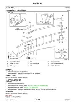

You shouldn't have to remove the overhead console to undo the nut that holding the antenna. You may need to remove the visor clips to give you more room to work with between the head. To remove the visor clip, just swing the visor out of the clip and then just grab and twist (counter clockwise or clockwise; whichever is easier) visor clip about.
If you want to remove the overhead console for whatever reason, you have to take the headliner down enough and undo the spring clip/washer-like that hold the overhead console to the headliner. I believe there about 6 clips holding it.
