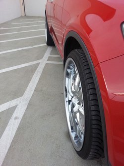

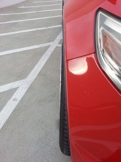

I have a set of 24x10 rims with +13 offset and 255/30/24 tires. I wish my rubber was wider, so 285 is better as long as the 35 aspect ratio puts the circumference similar to OEM. Without spacers, my +13 is pretty flush. Wider tread will certainly help.

I think my stock wheel offset is 50+. The way yours looks is how I would like mine to look. Do you have any pics with the rims you can post up? Thanks, I appreciate your help.
Since you asked. Everybody else, cover your eyes.
These are the same pics I posted on some other thread a while back. 1st gen with no spacers and no suspension mods. 24's look better on 2nd gens.

Look cool... where are your center caps? How does it ride on those 255/30 tire? Any blow outs?
