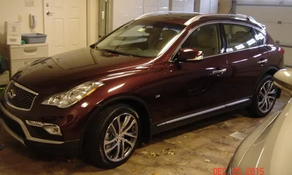

My wife bought a new QX50 and the brakes do not compare with any other brand that we have owned or driven. The pedal is a little softer and a little lower than other cars, and it does not have the "instant stopping power" that we expected. We have owned many Infinitis (FX45, FX35s, FX37, G35 coupe, two M sedans and all had great brakes. We took the car to the dealer and after waiting for about a half-hour they told us it was normal. They asked if we wanted to drive another one and we declined, as were out of time on that day. Anyone else notice this?
