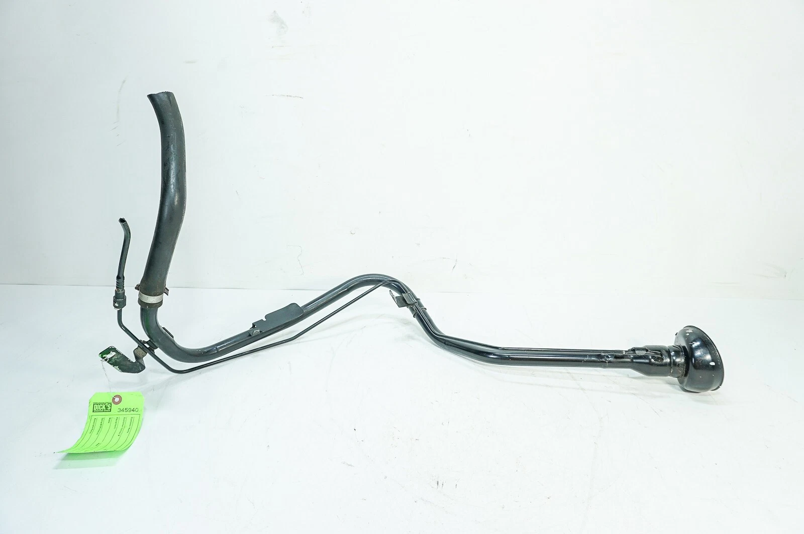

Part Number: 17221-1CX0A i have this one got it from ebay new from Israel and my mechanic told me it doesn't fit i asked why it doesn't fit he told me the vent tube is not the same diameter every thing else is okay i asked isn't there an adapter hose or fitting something guess not as far has i know the fuel tanks are still the same with the same exact connectors checked ebay photos diferent second gen year models and they look the same

so my local infiniti finally got my breather tube (17338-1BA2A) but now how is it suppose to connect on my new filler neck is there a special connector that goes from small to a bigger diameter or is it just a rubber hose

as you can see there's a special connector on the breather tube and the breather tube (17338-1BA2A) that i got from my local infiniti didn't come with that connector and for this fuel filler neck 17221-1CX0A) i need this hose
HOSE-VENTILATION
Part number: 17226EG010
The tube that you received from Infiniti...is it made of plastic or rubber and do the ends have that ribbing on the ends? That's usually how those ends hold on the tube
it is made out of metal with the expanded rings to be inserted into a rubber hose and a clamp as you can see on this picture part #17226+A connects with 2 hose clamps to part #17224N and with another rubber hose and clamps connects to the fuel tank
without getting into it too much, there's just a few more parts left to build this out. Looks like they ran away from the plastic quickconnect version and went for the metal and rubber setup...which is actually a better setup and more versatile.. when I was checking their diagrams and part numbers, they didn't have all those pieces, they had the one plastic tube...not surprised as Infiniti tends to have these mistakes in their diagrams during transitions...but also the diagrams were listing Dominican and Panama as the only options..but it appears they opted to just go with one set up worldwide to have less parts produced. But that's okay, the objective here is to get it hooked up and done even if it's just a few tubes and hoses..

17336-1BA2A or 17336-EG005 (Just need one). This is what attached to the gas tank. Worst part is not being able to see either of them. Curious, do you know if the metal tube you have, the diameter of of this tube is the same diameter as the tube that stick out of the gas tank? If you have the old quick connect hose from when you had the old filler tube, you can pull that quick connect off and put that into the rubber hose that will eventually connect to the gas tank.
Also, the fuel filler tube you have, does it look like the vent tube uses a quickconnect like in the photo you showed above or can it accept a rubber hose?
