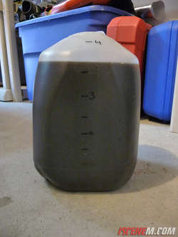

-MEASURE HOW MUCH FLUID YOU HAVE DRAINED. I USED AN OLD MILK JUG WHICH I MARKED WITH 1/2 AND 1 QUART LINES.

-HERE IS AN OLD VERSUS NEW FLUID COMPARISON.
ABOVE FLUID IS NOT AS DARK AS IT SEEMS IN THE PICTURE:

I am probably going to do this again in the next 100-200 miles, just to get more of the old fluid out.
Did another drain and fill:
Old Fluid: (After 39,000 miles)
After 1st drain and fill: (about 100 miles since 1st drain and fill)
I am going to extract some fluid from the fill spout after about 100 miles to compare after the 2nd drain and fill.
