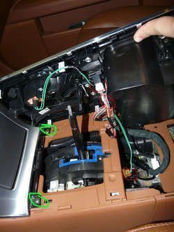

Sorry to open up an AGE LONG thread, buuuuut how do you remove the ribbon cable?
So far at least two members have broken their ribbon, and I don't want to be a victim.
I've removed the white clip for the connection on the bottom,
but I can't remove the top connection(the ribbon cable):
theres a push button, on the side in the middle.. push in and pull
---------- Post added at 04:45 PM ---------- Previous post was at 04:45 PM ----------
dont tug on the wire but with ur nails pry the top and bottom out
Thank you! Got it.
If anyone was wondering, I used a screwdriver to push the button, since the the tab is so small.
