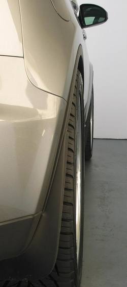

    Only trimming of the wheel well is required. It is very aggressive, +15 on a 9" wide wheel is +38 out more than stock. This makes it flush with the fender. Yes, I decided not on a staggered setup and just got 9" wide all around. Makes things easier and cheaper and of course as you mentioned, I can now rotate them all around.
    Note that this is Rookie's photo of his car on 22x9 w/ +15 offset (Viet, I hope you don't mind me sharing, I found it on one of your posts). I got this setup because Rookie had it and it looks great. He is lowered and it does require the trimming as I mentioned, but no big deal. I'm going to go trim tomorrow to prepare while the wheels come in.
    I like the fact that I don't need spacers. The only other offset would have been +35, but I loved how Rookie's car looked.

    Awesome thread. Very cool to see everyone researching and sharing. Alexus1 put on 19x10.5 +22 rears, his wheel itself was very flush with the rear wheel wells, even more than the 22x9 +15. Using a 285 on the 10.5" he was a little over but not by by much.
    Tire sizing is next in the wheel and tire configurations. The more sidewall bulge the more likely an aggressive offset will rub, tire height is also an issue if you go with tire bulge. Shorter tires can help with not rubbing but will add wheel well gap.
