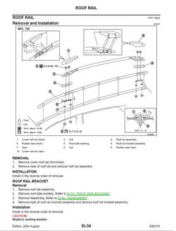

    For the roof rals you have two options.
    First if you pop off the caps on the end of the rails you will have some nuts under there, you can unscrew those and remove the rails. You will then be left with bolts sticking out of the roof...you can either cut the bolts flush with the roof or remove the headliner and unscrew the rail brackets and remove the rail brackets.
    after you cut the bolts or remove the brackets you will then cover the area with end caps that you get here http://www.trademotion.com/partloca...d=2614&make=14&model=Fx&year=2006&catalogid=2

    Welcome to the scene. The rear FX35/FX45 emblems are just two sided adhesive so easily removed.
    For the rails.
    Should be pretty straight forward, end covers come off and should expose 2 nuts at each corner. Remove the nuts and off the rails go. At that point you have a choice of dropping the headliner and getting the bolts out from underneath or cutting the bolts off. Most have opted to cut the bolts off. Color coded covers are available from the dealer.

    Protect the surrounding area with cloth or tape, use a cutoff wheel on your dremel. Make sure you cut off enough so that the cap will fit.
    If you are worried about accidentally dremeling your paint you might want option 2 and remove the brackets from beneath the roof.

    Hey Rookie,
    Is there any chance of getting the link to that website where you got that page from the service manual?
    Thanks

    There is no online link for these documents. What you are seeing is a uploaded pdf file. You can purchase a cd rom on line which has all this info plus others.
