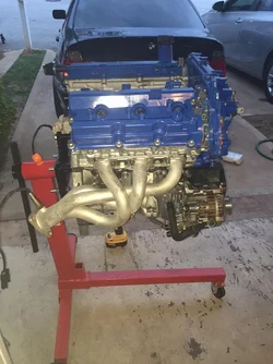

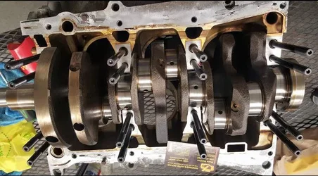

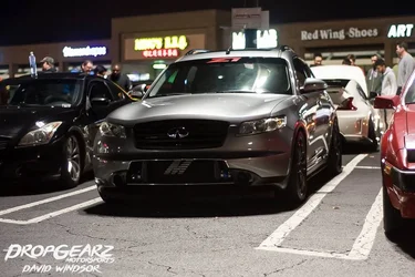

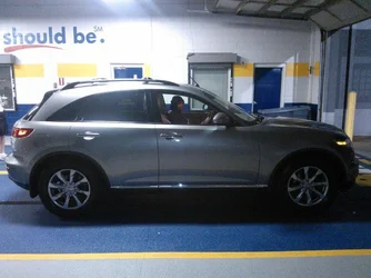

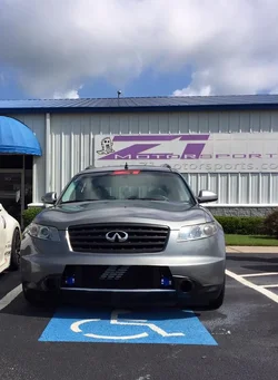

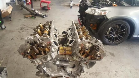

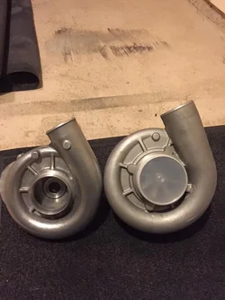

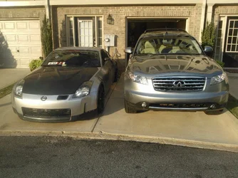

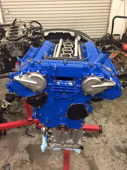

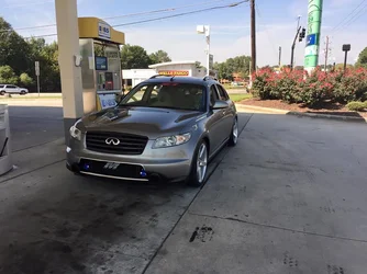

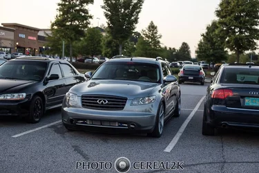

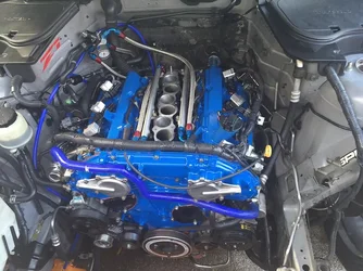

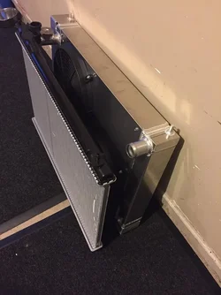

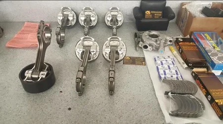

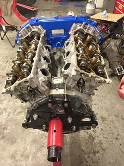

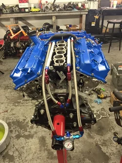

    Met this owner through Facebook and he had trouble uploading his progress a while back, so he gave me some photos from his profile and on VQ|Nation as well as other VQ group pages 1.jpg

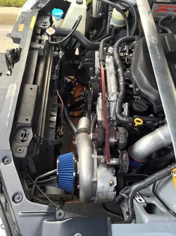

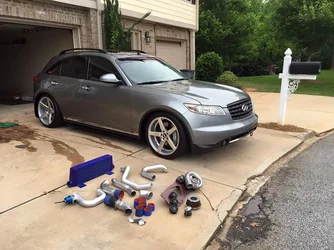

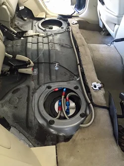

    Lol, he's been on Facebook posting his progress.. unfortunately, he parted out about a month ago and is going the CTS-V route

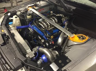

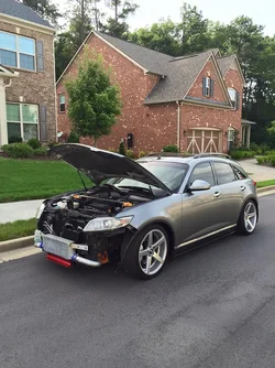

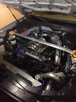

    sweet build, but how did that transmission hold up to all that power? CTS-V is definitely a better platform for going fast than a g35
  14. OP
    OP
    g0ldm4g3
    g0ldm4g3 Would ya just look at it iS VIP
    Messages:
    5,647
    Likes Received:
    133
    Location:
    Richmond, TX
    Car:
    2006 FX35 RWD
    Name:
    Nnaji
    The trans had upgraded clutches, upgraded transgo kit valve body, 2900 stall, -4 braided lines with 34 row trans cooler, LSD 3.53 gears and one piece aluminum driveshaft.
    Trans upgrade $2000
    G35 LSD $250
    Driveshaft $500
    He did 90% of the work myself so labor cost isn't factored in the price.

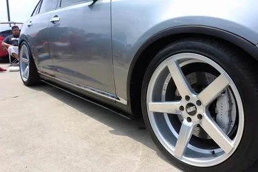

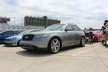

    @g0ldm4g3 Can you find out his tire size for me ? I like how it sits

    I didn't know there was a whole thread on my build on here, I don't really come on here because sometimes the questions get overwhelming. But the silver wheels on my first setup was A set of STR and they were 20x10.5 +15 REAR & 20x9.5 +18 FRONT. When I did the new setup I went with lighter wheels and radials, the black wheels were ENKEI GTC01 and they were 20x10.5 +22 square and about 22lbs per wheel about $620 per wheel.
