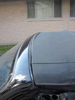

After that I decided to attack the soft top. Looks like the frame was bent so the top would not latch on one side. In this photo, the far side of the top won't latch.
So I found the frame member that was bent and rigged up a floor jack against the house:
Here's a shot from the inside of the car - you can see the gap at the top. By pushing out on the frame, the gap began to close:
After a couple tries, I got it to latch. Not perfect (heavy rain gets in) but at least I still have a car to drive when it rains instead of calling in sick! In this photo the closest side is the one that I just got to latch.

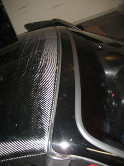

Even after getting the soft top to latch, it still leaks when it rains, around the side windows. The soft top with frame weighs in at 70lbs and I decided I wanted to step up to a Carbon Fiber hard top. Removed the soft top (not exceptionally easy).
I removed the parcel shelf carpet and the soft top with rain rail. With the hard top on I don't need the rain rail, but that's how the carpet attaches to the car so I ended up putting it back in.
First shot on the car. You can see the lexan window sitting on the trunk. The hard top weighs in at 24 lbs. Easy to take on and off alone.
Lines up very well - you can use the factory latches or some lightweight brackets that came with the car. I went with the brackets for a more permanent install. All the holes are slotted in the brackets so you can get it perfect if you take the time.
The top will have to come off one last time to install all the weather seals around the side windows. Hopefully I can finish it up today.
