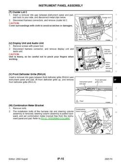

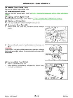

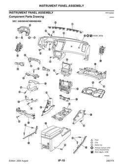

FX Dashboard Assembly

Has anyone come across videos of replacing the dashboard that are in English? I've seen the video of the guy with the Infiniti shirt on that looks like it was taken from 10 feet at the back of the car....
