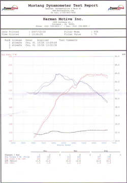

    I had some time this past Friday after I was at Technosquare so I decided to finally get a dyno test for my 45. Whatever the numbers are are the numbers and it is a good baseline for whatever mods I do in the future and I will take it to this facility for future dyno tests if any. The shop is called Harman Motive. It is a very nice shop with knowledgeable staff. They mostly tune, fabricate and build up suburu sti's and bmw's. The facility dyno was just amazing.
    http://www.harmanmotive.com/catalog/index.php
    Here a some pictures from the test.

    Looks like avery nice shop. Wonder if they could drag Tadashi down there for tuning on the Dyno.
    A/F looks really low.

    ...are you looking at the same dyno I'm looking at?????? Those AFRs look absolutely fine.
    220 hp / ft-lbs torque? That seems a little disappointing considering I pulled 200/200 in my '35 :frown: on a Mustang AWD dyno as well.

    I thought mid 14s was considered the perfect mix?

    The shop is really close to TS so I'm sure something can be worked out between the two shops but $125.00 per 3 runs is not cheap.
    And the A/F is not low it is right about where it should be.
    I know Cube, the numbers are not the greatest but they are the numbers
    nonetheless. And a fair and accurate comparison cannot be made between 2 dyno sheets when each was done at different facilities with different conditions even though they were on the same manufactured machine. Just too many variables to be considered.
    I will probably get my TS retuned because I had my hitch installed on my FX when I first did the reflash and they did compensate me for that. Now that the hitch is gone we can probably go to a bit more aggressive map. I don't know how much more HP or TQ this give me but it would be interesting to see the difference.

    Yes, that is a perfect mix but you want a more richer mix when you or getting on the throttle.

    Looks like I am running a bit richer mix then you are Dave, but I do not know why. You might ask Tadashi this question as he would be better qualified.

    Not bad numbers coming from that low-reading dyno. Afr's are about where they should be. The 35 dyno sheet above looks great, but doesn't really compare because it's RWD, which loses less power to the wheels than the AWD drivetrain. Also, keep in mind that they are different dynos. Think of dyno numbers as a tuning tool, rarely able to be compared on paper.
