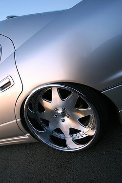

    Here's the tuck that i'm looking for. Kinda JDM VIP inspired but not as crazy as the ones you see with camber so negative that the car is riding on the sidewall of the tire. I also don't want to stretch my tires to make enough room to rest the quarter panel on the lip (too scary to stretch 25 series tires)

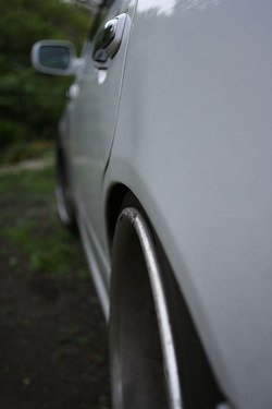

    Don't want to go this crazy.. stretched tires are scary.
