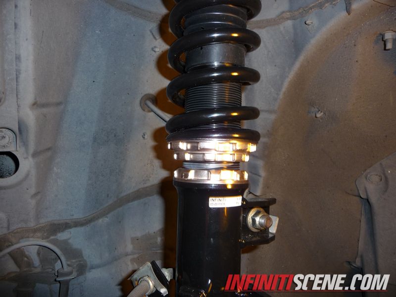

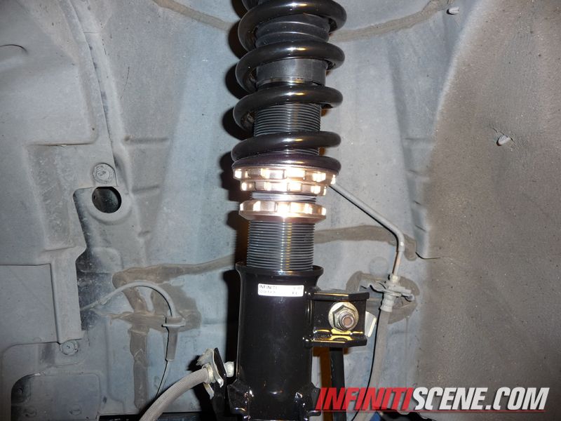

    DIY Adjusting BC Coilovers (Lowering Ride Height)
    IF YOU USE AND LIKE THIS DIY, PLEASE +1
    ADJUSTING BC COILOVERS (LOWERING RIDE HEIGHT)
    TOOLS:
    SUPPLIED SPANNER WRENCH’S
    CALIPER OR SOME OTHER MEASURING DEVICE
    SAFETY:
    ALWAYS USE QUALITY JACKSTANDS WHEN WORKING UNDER YOUR VEHICLE.
    NEVER WEAR LOOSE FITTED CLOTHING AROUND A RUNNING MOTOR.
    ALWAYS WEAR SAFETY GLASSES.
    PLEASE STAY SAFE.
    FRONTS
    MAKE SURE (A) AND (B) ARE TIGHTENED TOGETHER BEFORE BEGINNING. ***WE ARE NOT GOING TO ADJUST THE SPRING TENSION***
    1. MEASURE HOW FAR YOU WANT TO DROP YOUR CAR WHILE IT IS STILL ON THE GROUND.
    2. RAISE YOUR CAR ON JACKSTANDS AND REMOVE THE WHEELS.
    3. MEASURE YOUR DROP THAT WE TOOK IN STEP ONE ONTO THE COILOVER AND MAKE A MARK.
    4. LOOSEN LOCK RING (C) AND MOVE IT ALL THE WAY UP TO THE LOCATION YOU MEASURED AND MARKED.
    5. USING YOUR SPANNER WRENCH TURN (A) TO THE LEFT (CLOCKWISE). ***DO NOT TOUCH (B) TO LOWER THE VEHICLE.***
    6. ONCE YOUR DROP IS ACHIEVED, TIGHTEN LOCK RING (C).
    7. PUT YOUR WHEELS BACK ON AND DROP YOUR CAR.
    REARS (COMING SOON)
    THIS WRITE-UP HAS BEEN BROUGHT TO YOU BY YOUR FRIENDS AT
    WWW.INFINITISCENE.COM
    See More: Adjusting BC Coilovers (Lowering Ride Height)
