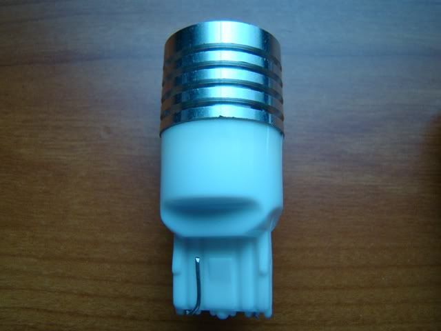

    I'm currently using this one from ebay. I didn't have any pic handy. I post a pic tonight.

    The Cree LEDs are pricey at $40 for the pair but are the best LEDs to use for this mod that we have found to date. Its much better than the standard LEDs like yours and what we have used. Plus they look really cool because they look like mini projectors within the housing. They are so much whiter, they sometimes appear slightly purple from some angles. But overall these bulbs are the best looking ones to get and I'm very picky when it comes to the right bulb and color.

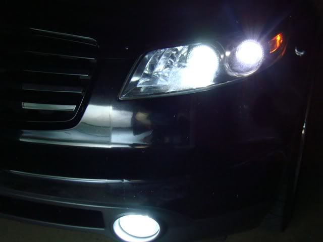

    Here are the pics of my DDM 6000K headlights, Cree LED from ebay & DDM 6000K HID fog

    Thanks man. Those look a lot better than mine. So is the link you provided a direct fit or will I need to specify the bulb type at checkout? If so what bulb type is it?

    Sir21, the link to the ebay buld above is the exact one you need. I a bit pricy, but I think it look the best and color matched pretty well. It looks "almost" like a tiny projector in the housing, lol. They are pretty bright, but not blinding to on coming drivers. AreoBFA and I try a few other LED and none come to out liking. You need to bend the contact at the base of the bulb though. The bulb is originally of type 7440, you need to bend the contact from the outter most slot to the inner on both contacts since the DTRL socket is of type 7443 to have it light up though.
