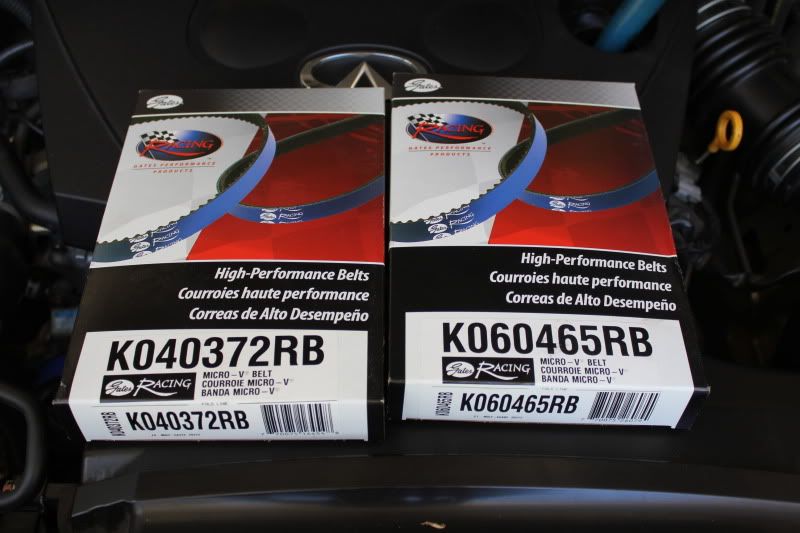

    If your changing one I would do them both----
    Gates Blue Racing Belts are what I used----
    GATES PART # KO40372RB $25.42
    http://www.discountfleetsupply.com/gatk040372rb.html
    GATES PART # KO60465RB $31.67
    http://www.discountfleetsupply.com/gatk060465rb.html

    It should end with digits 40372 for the accessory belt. If you check Gates website...they will give a directory of suppliers. There should be another place around you that has them...or I have an extra set of brand new ones if your interested??

    Found the Gates belts at another O Reilly. $48 for both. Going to pick them up now & heading to Stu for his help. Thanks for the help everyone!

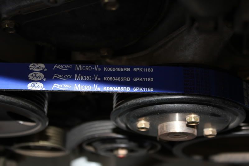

    It took less than 10 minutes to do. You don't have to pull the bottom cover it's pretty easy to do from the top. Just loosen the two tensioner pully center bolts a little then back out the adjuster bolts directly under the tensioner pulleys. Swap out the belts and tighten tensioner bolts till you can only twist the belt by hand about a quarter turn then tighten center bolts of tensioner pulleys. You don't want to over tighten them or you could cause bearing damage to one of the components run by the belts.
    If either belt squeels repeat adjustment by loosening center bolt and tightening tensioner bolt just a little more.

    Quote Originally Posted by MTN FX View Post
    If either belt squeels just tighten it a little more.
    I dropped the cover just to make it easier to get at the tension adjuster bolts. With the engine still hot, it's not fun to be running your fingers around just anywhere. Tightened them back down until they felt the same as before, and similar to mine. I noticed the bigger belt was a little looser.
